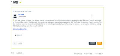

I am able to solve the issue. The issue is that the memory section 'ethbuf' configured for ETH Tx/Rx buffers and descriptors was not accessible by Ethernet0 Bus master. The Ethernet0 Bus master had to be given access by configuring the SMPU's Region Descriptor n, Word 2 properly. The Bus master id was 5 for Ethernet0  and the SMPU for the ethbuf region was SMPU_1. After giving the access, I do not see the EBERR on setting RDAR bit after setting controller mode to ACTIVE.
