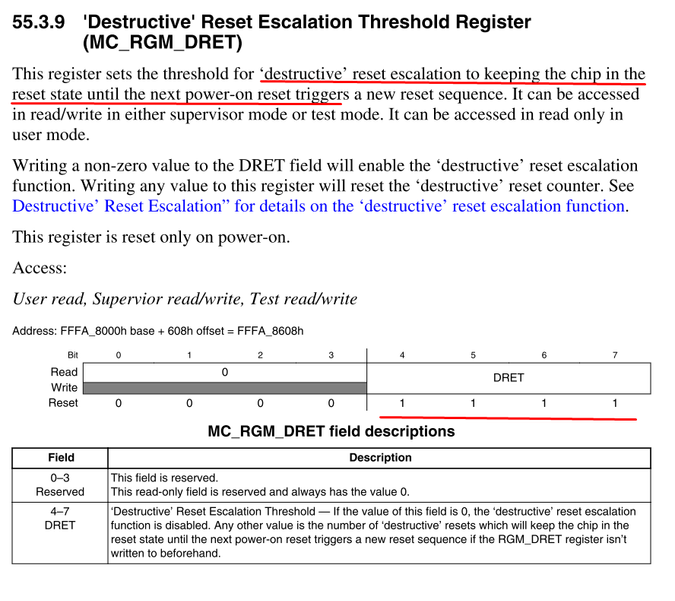

Question: Is there a limit to the number of SWT overflows?
There is no such limit, if you do not set it in SWT Control Register (SWTx_CR):
program is reset by SWT for 15 times each time, the development board will be in a state of constant reset,
Ok, that is clearly enabled destructive reset escalation on default 0xF.
Peter

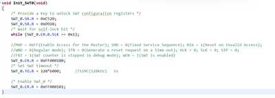

This is my configuration
