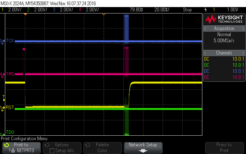

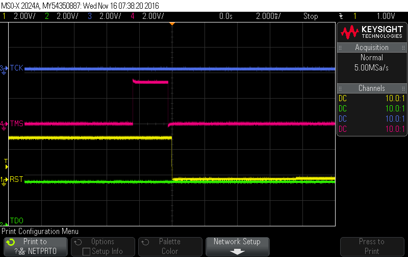

Hi, I have a new custom MPC5748G board and am not able to connect to it with my PE Micro Multilink JTAG tool. It looks like TMS is going high to put the part into test mode but then the PEMICRO connection manager is reporting that it can't communicate with the target processor.
Here are some scope shots of the JTAG signals as labeled when I attempt to connect to the MPC. I verified POR is not being asserted at any point in the sequence.
Any suggestions on getting the MPC to connect to JTAG?

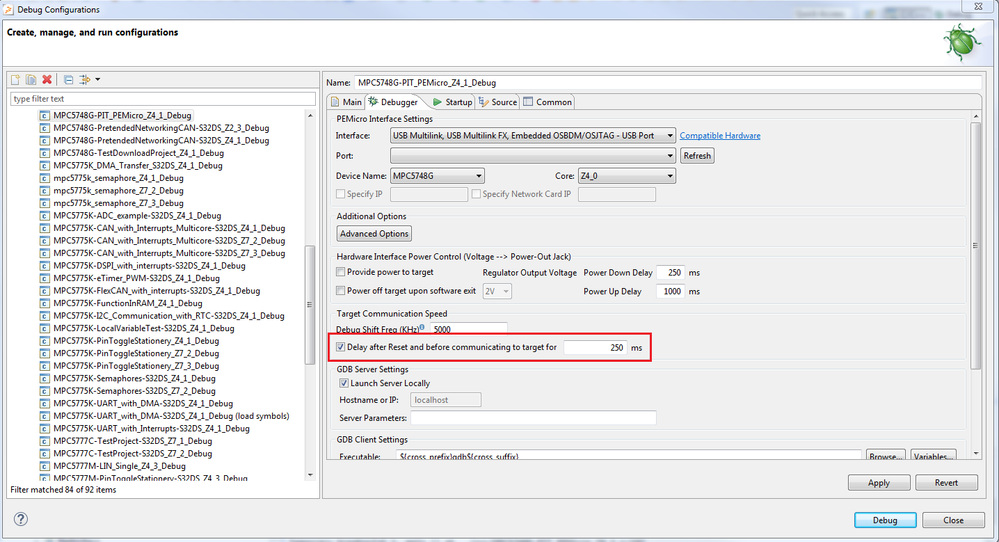

which IDE you use for debugging? If you use S32 Design Studio version 1.0, there is known issue. You have to open debug configuration and set 250ms Delay after Reset.
If you use different IDE, please write me back, which IDE it is. Could you please also write me, which PE Micro debug probe you use?

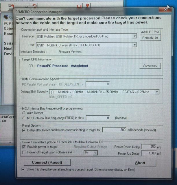

Hi Martin I am using the PE Micro Multilink Universal Tool and just attempting to connect with PROGPPCNEXUS Programmer utility. Screenshot attached with options selected..
Steve

just one point which could help me a lot now. Could you please measure the voltage on TMS pin (it is pin PH10 directly on microprocessor)? If you measure voltage about 1.2V on PH10 pin (or at least less than 3V), the 74LVC1G08 gate definitely does not work correct (Most probably incorrect assembly - rotated in incorrect way).

I don't understand the comment about the 74LVC1G08 gate. My design does not use any AND gates and you can see on the scope shots I attached earlier, the JTAG signal+reset voltages go to 3.3V.
One deviation I made from the EVB design was that I wired RESET on pin L1 directly to the reset pin on my JTAG debugger. I wonder if that could be causing my issue.
