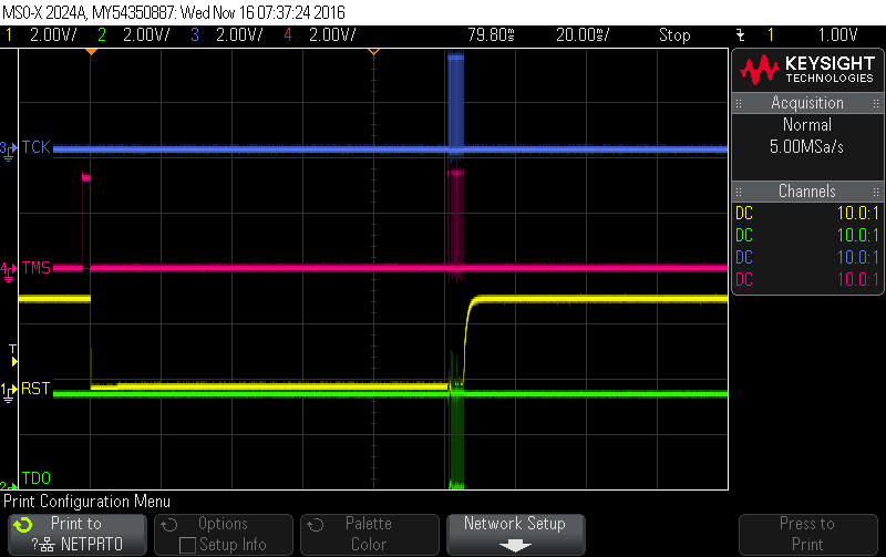

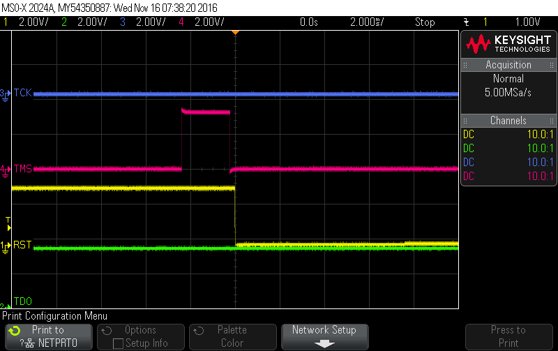

Hi, I have a new custom MPC5748G board and am not able to connect to it with my PE Micro Multilink JTAG tool. It looks like TMS is going high to put the part into test mode but then the PEMICRO connection manager is reporting that it can't communicate with the target processor.
Here are some scope shots of the JTAG signals as labeled when I attempt to connect to the MPC. I verified POR is not being asserted at any point in the sequence.
Any suggestions on getting the MPC to connect to JTAG?

just one point which could help me a lot now. Could you please measure the voltage on TMS pin (it is pin PH10 directly on microprocessor)? If you measure voltage about 1.2V on PH10 pin (or at least less than 3V), the 74LVC1G08 gate definitely does not work correct (Most probably incorrect assembly - rotated in incorrect way).

I don't understand the comment about the 74LVC1G08 gate. My design does not use any AND gates and you can see on the scope shots I attached earlier, the JTAG signal+reset voltages go to 3.3V.
One deviation I made from the EVB design was that I wired RESET on pin L1 directly to the reset pin on my JTAG debugger. I wonder if that could be causing my issue.

Hi Martin you are correct it turns out I was using an old version of the PE Micro Flash Programmer utility. I needed to use PROGPPCNEXUS Programmer v6.9 released 11-Oct which added support for MPC5748G cut 3. Now it is working and we got an LED blinking.
