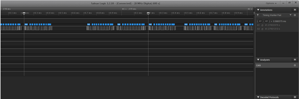

With a quiet CAN bus there is no problem but on loaded bus (bus load +-50%) some frames are simply not transmitted at all and the MB returns to the inactive state without any warning that the frame has not been transmitted.  This error occurs when we try to transmit while another device is sending on the bus at the same time.
It looks like arbitration does not take place and the can controller will not retry later.

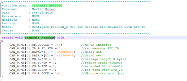

We noticed in some of the NXP code example, that you are forcing CS CODE to INACTIVE just before preparing the MB:
Is it really necessary and why ?

Writing INACTIVE at the beginning of transmit function is not needed if user know the message in this MB was already transmitted and the MB will not be included into arbitration process. Then writing to the MB is safe.
