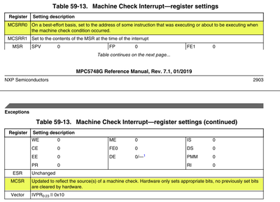

This is typical symptom of Read-While-Write error. I can see that all three mentioned blocks belong to partition 7. That means there's no problem with programming code (I can understand from your description that the code is running from RAM) but it could be caused by interrupt. Did you try to disable interrupts before the programming?
2. Is data cache disabled? Or did you try to invalidate the cache after programming?
And what does it mean that it "fails"? You just can't see your data in that block or is machine check exception IVOR1 triggered? If so, what is the content of MCSRR0 and MCSR core registers? This could help to find what accessed the flash.

2. I do not enable CACHE, it will not cause IVOR1 triggered. I want to write the three block's data into the
addree, but only the third block has problem, the data is not expected, it's all 0xFF.
But when I debug the code , the third block can be write the expected data into the address by the breakpoint. It means I can write the third block by the step over. But It's 0xff when I run the project without breakpoint. You can see the image.
I do not understand why it will cause the problem like this, what should I check to solve it ?
