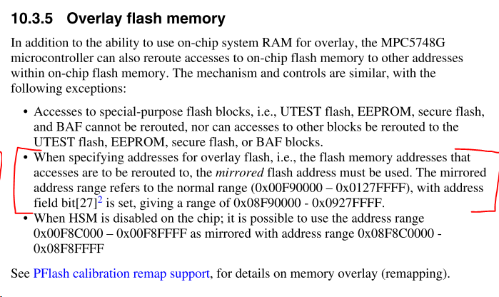

there's important note in the reference manual:
That means you should use mirrored address like this:
PFLASH.PFCRD[0].Word0.R = 0x09200000;
PFLASH.PFCRD[0].Word1.R = 0x01000000;
Then you will see content of address 0x01000000 at address 0x09200000 (not at 0x01200000 - this remains unchanged). The rest of your initialization seems to be correct.

lukaszadrapa
as I wrote, the remapping is visible only in mirrored flash address space. Normal address space remains unchanged after remapping. That means your code must be compiled to execute from mirrored flash address space (if it is not position independent code). And that also means you can't execute that code from normal address space.
Because there were more questions about this, I shared simple example here to show effect of the remapping:
https://community.nxp.com/docs/DOC-342943
Lukas
