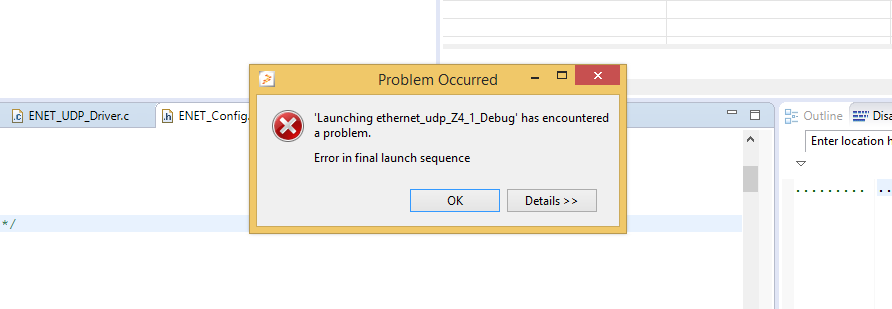

I have a problem when trying to upload the source code: in the final stage of debugging this error occurred
Could you please tell me what changes should I do to run this application successfully?

martin_kovar
Hi Alex,
this is the problem of S32DS. Look at these following threads. We have already solved this problem, so there are some points which you can try.
I have an error : Launching L1_Z4.elf has encoutered a problem.Error starting process.
P&E Connection Assistant Error
Martin
3,890 Views
alextimpau
Hi Kushal Shah!
Thank you very much!
Alex.
