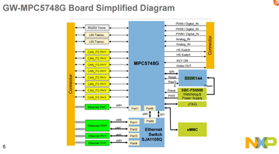

when we flash new MPC5748G via OSJTAG debugger device, it is mentioned the error message: "Warning:Device is not detected or may be censored, please check connections or please ender p/w in GDB server parameters within debug configurations using the flag -uncensorpassword = n, then restart the debug session".
issue description:
the issue was described in attachment [warning:device is not detected or may be censored. please check.... using the flag -uncensorpassword=n,...]
further information:
we found there is a S32K144 CPU on the board, we are not sure whether this CPU has limitations on the MPC5748G, or how to flash when S32K144 are embedded.
we remember that S32K144 was not embedded on MPC5748G before.
help needed:
how to flash MPC5748G with S32K144 embedded? any special setting needed?

First I would like to ask you whether you have ever had this board running or it is the first attempt to connect to the device?
Here you may check how to connect with Multilink and S32DS:
http://www.pemicro.com/blog/index.cfm?post_id=180
Maybe you may find an answer there.
Also please see following guide to check whether power is properly attached to the MCU:
https://www.nxp.com/document/guide/get-started-with-the-mpc5748g-secure-ethernet-gateway-reference-d...

Yes, you are right, we have not yet had this board running, and it's first attempt to connect to the device via flash the program.
the full warning messages are:  "Warning:device is not detected or may be censored. Please check connections or please enter password in GDB server parameters within debug configurations using the flag -uncensorpassword =n, then restart the debug session."
further information here:
1. we are nearly sure the debugger is well, the software is well
2. we checked the PIN11 Voltage=3.3v;
3. we have S32K144 MCU embedded and removed, but still can't flash to the MPC5748G.
Do you know any special setting if the first time to flash the MPC5748G?
Your quick response will be highly appreciated.
1,999件の閲覧回数
davidtosenovjan
Does the RESET LED diode light up?
How you have set jumpers J12 and J13?
