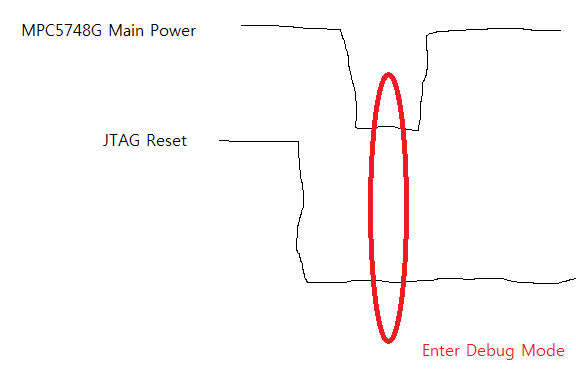

hi
I erased all block from C55 Driver.
I try attach JTAG. but didn't attache.
I think erased BAF block. Is it right?
and Can I get BAF Image or other recovery solution(use t32??)?
T32 is support "Halt Core at power-on reset" so can attached.
how to make "Halt Core at power-on reset" ?
My system can control JTAG pins and Reset Pin. Can I make that?

lukaszadrapa
regarding BAF recovery - see this thread:
https://community.nxp.com/message/806415?commentID=806415#comment-806415
Yes, you can do that. Background: if there's no code in the flash which disables watchdog, the device will be reset several times after power-on and then it will be forced to permanent reset due to reset escalation feature. To avoid that, it is necessary to force the reset pin low, then power-up the device, enter debug mode during reset and disable the watchdog. That's what the "Halt Core at power-on reset" does.
Lukas
4,301件の閲覧回数
kimyoungsu
I think enter escalation feature under picture. is it right?
if under picture right then my h/w modify to control main power.
4,301件の閲覧回数
lukaszadrapa
yes, that's exactly what you need to do.
Lukas
