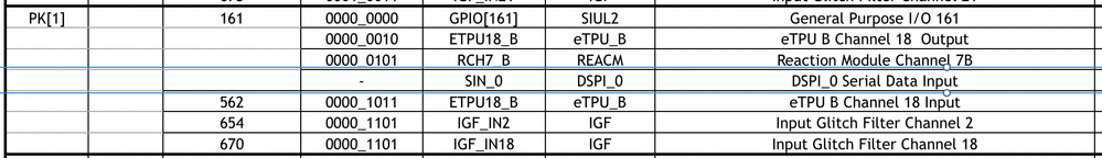

Within the reference manual for the MPC5746R, the above mentioned document can be found as an attachment for knowing required pin configuration information.
In the "IO Signal Table" sheet of the aforementioned document, sometimes the "MSCR SSS" column contains a '-' instead of an 8 bit number. I previously assumed that a dash ('-') meant to use the same MSCR SSS code used previously. But I now see in the sheet that if the same MSCR SSS code is to be used, it's typically duplicated. I have attached a screen shot with an example:
You'll see the dash I'm referring to in the highlighted row, as well as the duplicated values in last two rows. What MSCR SSS value do I use when configuring SIN_0?

That's great for that specific pin, but what about all the other cases in the spreadsheet where the MSCR SSS is '-'?
Eric
Hello Eric,
it is the same for all pins. If there is - in Signal description table, set SSS = 0 and look, if this function is input or output. According the direction of the function, you set (or not set) input buffer.
Martin
if you want to use SIN_0 function, set SSS = 0 and enable input buffer. Set ODC Push-Pull.
