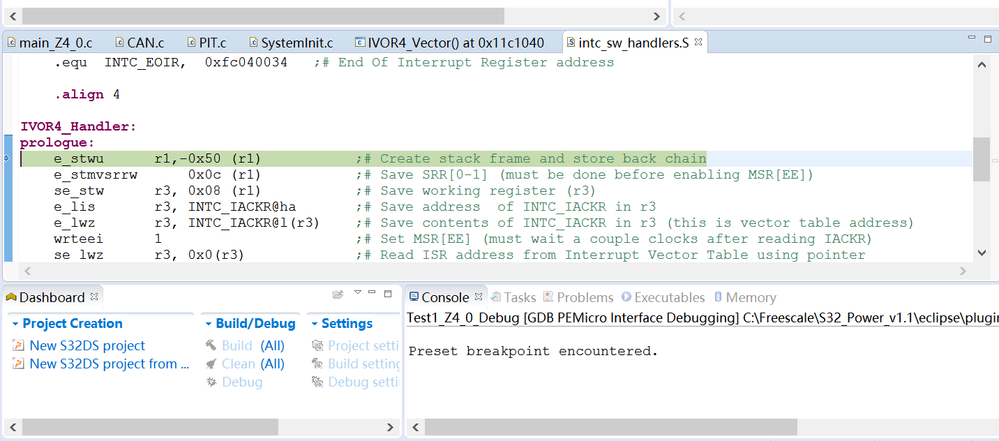

    I am initiating FlexCAN of MPC5746R.  As the manual said, I negate  CAN_MCR[MDIS]  to enable this module as
the first step, but after this step, the program seems to run fly, it enters some kind of interrupt handler IVOR4, as the figure shows below:
It would be highly appreciated if you can provide successful  CAN init code for MPC5746R.
