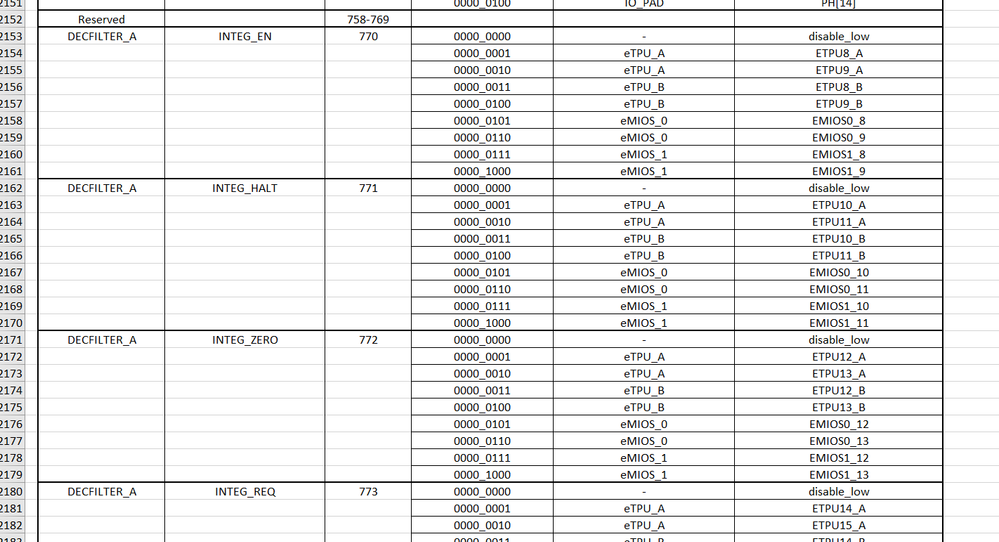

davidtosenovjan
There is no internal data bus between ADC and DECFILTER (on MPC5777C and several MPC56xx devices called 'Parallel Side Interface'), that's what was mentioned by 'no direct hardware interface'. But there is a hardware interface between eTPU/eMIOS and DECFILTER (triggers).
Regarding MCR[ISEL]=0, I will report it as a documentation error. Thanks for pointing it out.

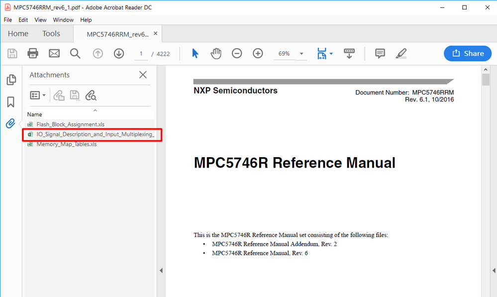

davidtosenovjan
Hi, routing on this device is made slightly different way and it is described in excel sheet embedded in the RM.
In the tab 'Input Muxing' you may see eTPU/eMIOS routing to decimation filters' integrators.
Regarding MCR[ISEL], you are right. Because on this device there is no direct hardware interface from the SAR and Sigma-Delta ADCs to the Decimation Filters on the device (because this device does not have eQADC module normally offering this feature). MCR[ISEL]=0 is not an option.
