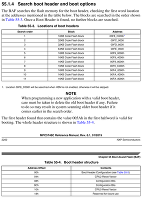

Inquiry about the swap method of partition6(0x01000000) and partition7(0x01400000) of MPC5746C. Application A is stored on partition6 and application B is stored on partition7. I was wondering if there is a way to call the desired partition during the boot process. Or please let me know if it is swappable.

Usually there's a bootloader which is always started after reset. This bootloader should check the presence of application(s), check their integrity if needed (CRC or Flash Array Integrity Check), check which application is the more recent one and jump to it.
Another option is to change the boot header after loading of new application but there's a risk that this operation will be interrupted by unexpected reset / power-down. Using a bootloader is more common way.

How to change boot header? Are you changing the address of the boot header? Or are you changing the data in the boot header? I tried to change the data in the boot header (0x00FA0000) using the flash_erase_program_mpc5746c example. But it didn't work properly.
I have two questions. I want to know how to check and boot the latest application and how to change the value of boot header. Finally, if I need a bootloader, do I have to implement a bootloader program?
