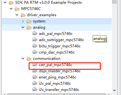

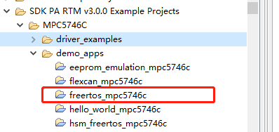

    currently using IDE for ‘S32 Design Studio for Power Architecture Version: 2.1’, SDK for SDK PA RTM v3.0.0, using the Demo in the SDK, the program execution to the operation of CAN or PIT resources will jump to the IVOR1_Handler interrupt. I don't know the specific reason.
Get the demo version from the SDK, as shown below:

Thank you very much for your answer. I seem to have found the problem. Currently, there is no OSC32K external pin in the MCU of the MPC5746C 100MAPBGA, and MC_ME.DRUN_MC.SXOSCON is enabled in the Demo of the SDK, but it does not judge and wait for MC_ME.GS. The .B.S_MTRANS bit is set to 0, so the program jumps to the IVOR1_Handler interrupt when the PIT register is manipulated.
It seems that the officially provided Demo Code does not distinguish the 100MAPBGA of the MPC5746C from other Pin packages
