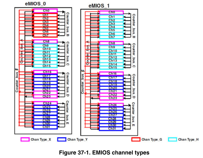

I understand from MPC5746C reference manual that channel no 23(type X) drives counter bus A.
Is there any other way to drive counter bus A?
Also, which counter bus is driven by channel no 7(of type G)?

only the channel 23 can drive Counter bus A.
See Figure 37-1 to know, which channels drive each Counter buses.
so
ch0 ... counter bus B
ch8 ... bus C
ch16 ... bus D
ch22 ... bus F
ch23 ... bus A
ch24 ... bus E
