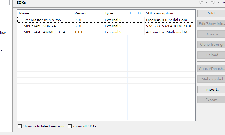

What is the SDK version?
3,070 Views
2548903578

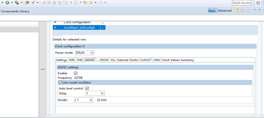

Hi, which model of MPC5746C is used? See if MC_ME.DRUN_MC.SXOSCON is enabled?
3,070 Views
2548903578
3,070 Views
my_souls
You look at the model of your MPC5746C, is it 100pin, does the external support 32kHZ crystal oscillator, if it does not support the external 32k crystal oscillator, please do not choose, in addition, which version of SDK do you use?
3,070 Views
2548903578
I am using a 176-pin chip, and I still interrupt when I remove the clock. The version I use is S32 Design Studio for Power Architecture Version 2.1
