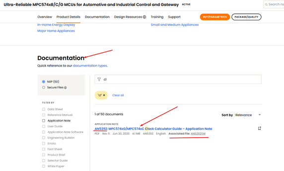

petervlna
there is a clock configuration guide:
https://www.nxp.com/products/processors-and-microcontrollers/power-architecture/mpc5xxx-microcontrol...
Such will ease your work with clocks and their configuration.
https://www.nxp.com/docs/en/application-note/AN5392.pdf
best regards,
Peter
363 Views
pstammii
Thanks Peter.
The issue was incorrectly configured clocks, as you suggested. Once I got that right I ended up just using the clock_manager inside Processor Expert to configure everything and initialized by calling the two functions below, which I learned about through some of the examples in the S32 SDK (the functions are in clock_MPC57xx.c). Just using the CLOCK_DRV_Init processor expert function was not enough.
