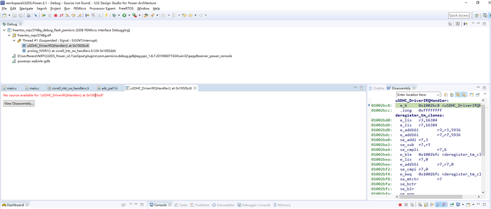

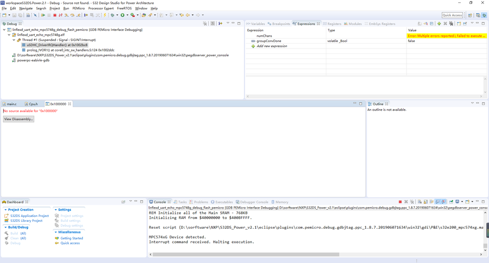

In the case of ensuring the normal operation of the operating system, once the ADC is added. "No source available for" uSDHC_DriverIRQHandler () at 0x1002bc8 "" will be displayed when the ADC is initialized.I do n’t know much about this chip, I really do n’t know how to solve this problem, and I did n’t look for similar problems and solutions, so I hope you can help me solve it. thank you very much!微信截图_20200410105353.png

petervlna
Hmm, ok, it will be hard for you to resolve issues when you have very limited knowledge on uC.
First it seems like you are missing some source files in project. Make sure you have al of them for compilation and there will be no warnings/errors (critical ones).
No source available mean you won't be able to see C code which is in that file. You will see only assembly instructions. This is usually solved by adding a source file to debugger GUI or by recompiling the project.
It is nothing critical, which prevents application from normal run.

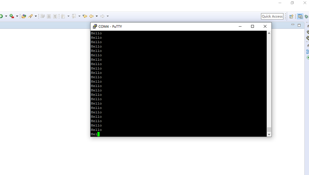

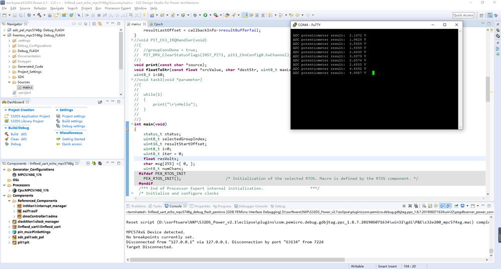

When no operating system is added, the ADC can work normally. After the operating system is added, the ADC initialization crashes directly and the operating system does not work properly. After I shielded the code related to ADC, the operating system can work normally.The last picture is the development board I used.微信截图_20200408112810.png微信截图_20200408132240.png微信截图_20200408132900.png微信截图_20200408133539.png
3,289 Views
2548903578
I experimented again, and there was really no problem. My configuration is basically the same as Demo, but that interruption error will occur.

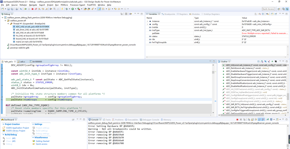

2548903578
I found the problem during debugging, but I don't know why it happened. This is the picture when I debug, I hope someone can help me, thank you very much!b311f274d66f67a3515d0ba723e2652.png
