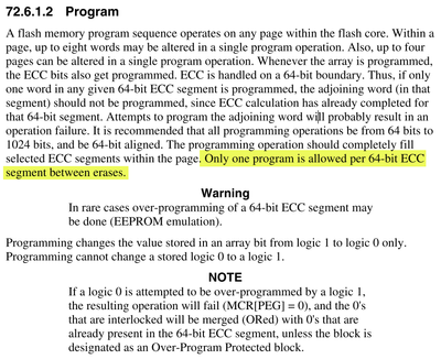

yes, if the double word is not fully erased, you can't program it again and it is necessary to erase whole block. This part of the reference manual explains it in detail:
It also talks about over-programming which may be done for EEPROM emulation. Notice that this is very specific case related to some patterns only, it should be used by our EEPROM Emulation driver only.
