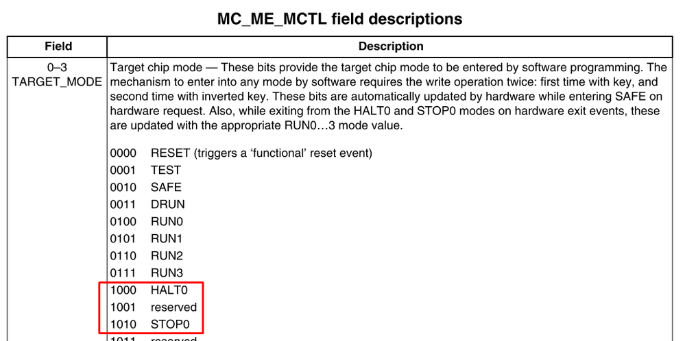

I have a development board which the MCU is MPC5744 and PMIC is MC33FS6522.
The development Board will get the information of Battery when the Car is Driving.
When the Car is flame-out , the development Board need into the " Low Power Mode "
So We have a question:
How to Let MPC5744P into sleep or suspend ?
Can you provide the information and SW example ?
1,105 Views
petervlna
This micro has 2 power save modes:
1. HALT0
2. STOP0
You can get to these modes via mode entry module by mode transition to these modes:
Refer to reference manual: 59.4.3   Mode Transition Process
Yes, here it is attached.
