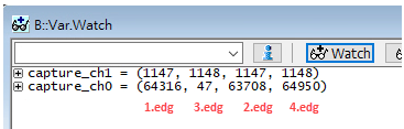

I implement frequency measurement function by using etimer module with cascade counter

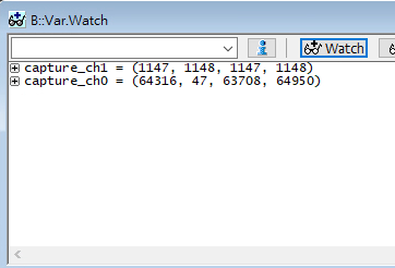

The calculated frequency goes wrong sometime with the below CAPT1/CAPT2 counter
The second element counter in capture_ch0 is obviously full and starts counting from zero.
So the second element in capture_ch1 should be 1 greater than the others, but the picture below shows that the fourth element in capture_ch1 is also 1 greater than others.
From the reference manual of MPC5744P I think all related counters should be frozen in the Hold register.I'm wondering why the counter I read looks like this.

I think the value of 4.edge are weird.
If the counter in capture ch0 is less than 65535, why the 4th counter in capture ch1 is 1148 rather than 1147?

3rd edge value is also 1148 so 4th should not be lower, but seems 2nd is lower then 1st.
You can try to stop capture logic after 4 edges are get and start it again after reading/calculation is done.

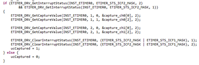

YL005

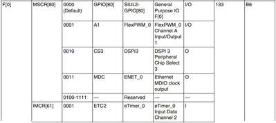

The input signal is measurement from F[0] (eTimer_0 Channel 2)
I cascade the eTimer_0 channel 1 and channel 2, the register of eTimer_0 is as attached files.
The code to get the counter is as below.
