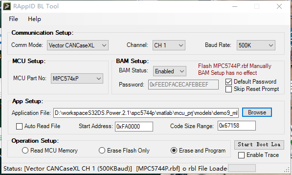

johnjiang888888
NXP MPC5744P
rbf: MPC5744P_S32DS_UART1_CAN0.rbf
tools:cancasexl+RAppID

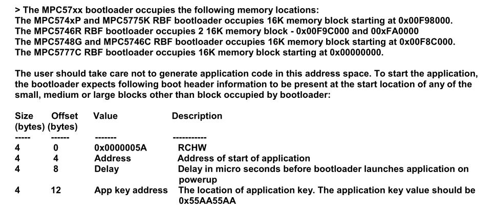

description:The program can be loaded successfully,But it doesn't work,Why?
1,075 Views
lukaszadrapa
did you follow these instructions in the user manual?
And this is from the release notes:
This is the most common reason. The application will not work if the steps above are not implemented.
Lukas

johnjiang888888
hello,where is my problem?

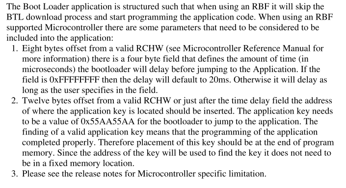

lukaszadrapa
it's not about the settings of Rappid tool or about the RBF file. It's about the application which you are going to download by the bootloader. You need to implement the steps mentioned above.

johnjiang888888
Problem has been solved,Thank you
