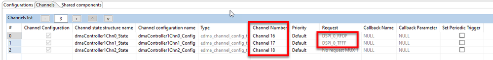

Is it at all possible to do blocking transfers when using the DSPI in Master mode with DMA? When I use the function: DSPI_MasterTransferBlocking() the software does not get out of the OSIF_SemaWait() function and never returns. The SPI was working when it was configured for using interrupts, but I want to change it to DMA to reduce CPU overhead. It is configured in Processor expert with RX DMA channel set to 16, TX DMA channel set to 17, TX additional DMA channel set to 31, also with the callback function defined as it was when I was using interrupts. Channels 16,17 and 31 are defined in the dmaController. I also initialize the DMA with the EDMA_DRV_Init() function.

I changed the DMA channels to what you have and now it also works on my side. Changed the Tx additional DMA channel from channel 6 to channel 18. I am not sure if this was the cause of DMA not working as there was also other changes done to the software, but they were not DMA related. At least it works now and all is good.

I need to configure a device with commands that are only 2 bytes long during initialization. That is the only place where I use blocking functions as the commands are sent directly after each other. During normal operation I use the non blocking DSPI_MasterTransfer. If I put a breakpoint in the DSPI_DRV_MasterCompleteDMATransfer, the software never reach this breakpoint. At this moment DMA does not work at all for DSPI Master mode. Am I missing something? It was very simple to set it up a DSPI for slave mode with DMA, I did exactly the same for master mode, but it is not working. The DSPI was working when using interrupts. Then I changed the transfer type from Interrupts to DMA in Processor expert, select channels 16 for RX DMA channel, channel 17 for TX DMA channel, channel 6 for TX additional DMA channel. Added channels 6,16 and 17 to the DMA controller in Processor Expert. I can not find any example where DSPI is used in master mode that is set up with Processor Expert. Do you perhaps have such an example? To me everything looks right, but when I do the DSPI_MasterTransfer(), the callback that I defined in Processor expert is never triggered.

it works on my side. What I did:
SPI configuration:
DMA configuration:
And I had to call:
EDMA_DRV_Init(&dmaController1_State, &dmaController1_InitConfig0, edmaChnStateArray, edmaChnConfigArray, EDMA_CONFIGURED_CHANNELS_COUNT);
That's all I configured and I can see that both DSPI_MasterTransfer and DSPI_MasterTransferBlocking are working (I used external loopback, so I received what I sent) and callback function is called when the transfer is completed.
