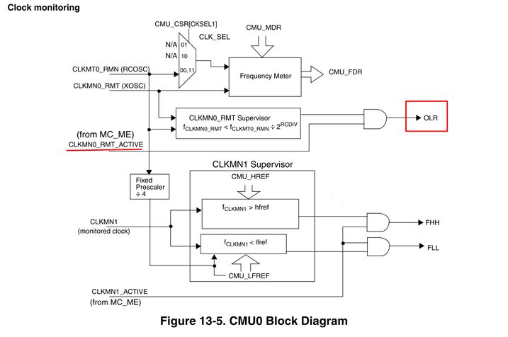

XOSC clock you mean? Then CMU if enabled and set will trigger OLR line. As picture above represents.

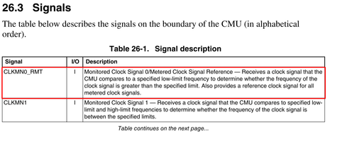

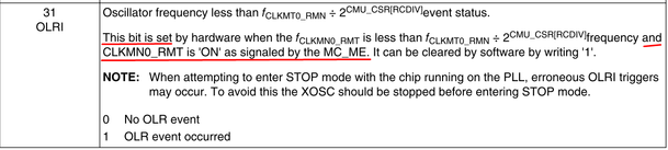

  • What do you mean by "CLKMN0_RMT" is ON as signalled by MC_ME? Should we set some bit in the MC_ME register? Where does that CLKMN0_RMT_ACTIVE come from?
  • "whether the OLRI bit is set only if clock is not available in the beginning?"---> I mean whether the OLRI bit is set or not when the XOSC clock is stable during the initialization process and after that the XOSC clock is going unstable and becoming less than IROSC?
So the clock must be enabled in Mode entry mode in the mode where you doing measurement. (XOSC)
No, it is set when you enable CMU, as the schematic represents.
