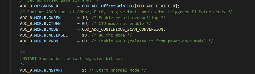

I am using SCAN mode @80Mhz clock rate.
I start the conversion in the startup task which only execute once.
I collect the converted data from CDATA reg whenever it is need by Application.
we have our own control board which we are using for testing.
This issue occurs when high voltage supply is turned on i.e.900Vdc. so it might be related to EMI but the ADC never recovers and counts reports 1373 counts constantly. This happens only in field as we cant replicate this issue in our HV lab.
below is the code for ADC setup and reading
Ali
ADC_0.MCR.B.OWREN = 1U; /* Enable result overwriting */
ADC_0.MCR.B.CTUEN = 0U; /* CTU mode not enable */
ADC_0.MCR.B.MODE = CDD_ADC_CONTINIOUS_SCAN_CONVERSION;
ADC_0.MCR.B.ADCLKSEL = 1U; /* 80 Mhz mode */
ADC_0.MCR.B.PWDN = 0U; /* Enable ADC0 (release it from power-down mode) */
NSTART Should be the last register bit set
ADC_0.MCR.B.NSTART = 1; /* Start normal mode */
READING of ADC converted DATA

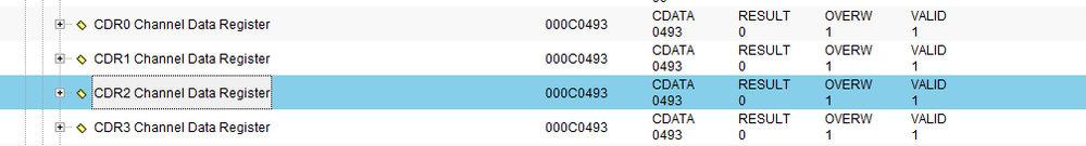

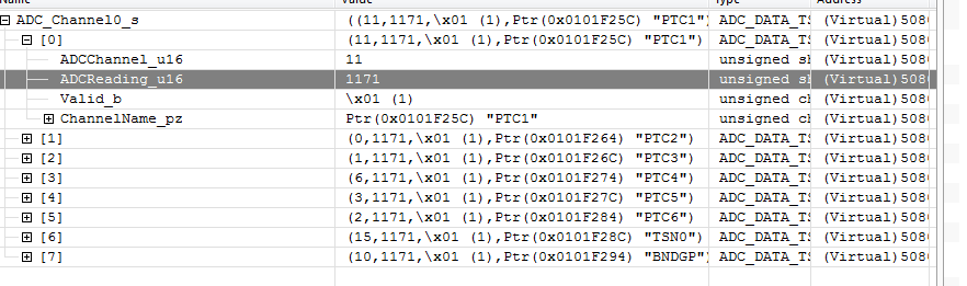

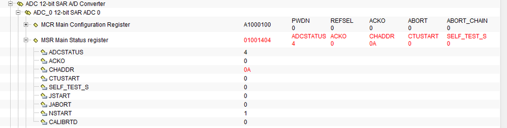

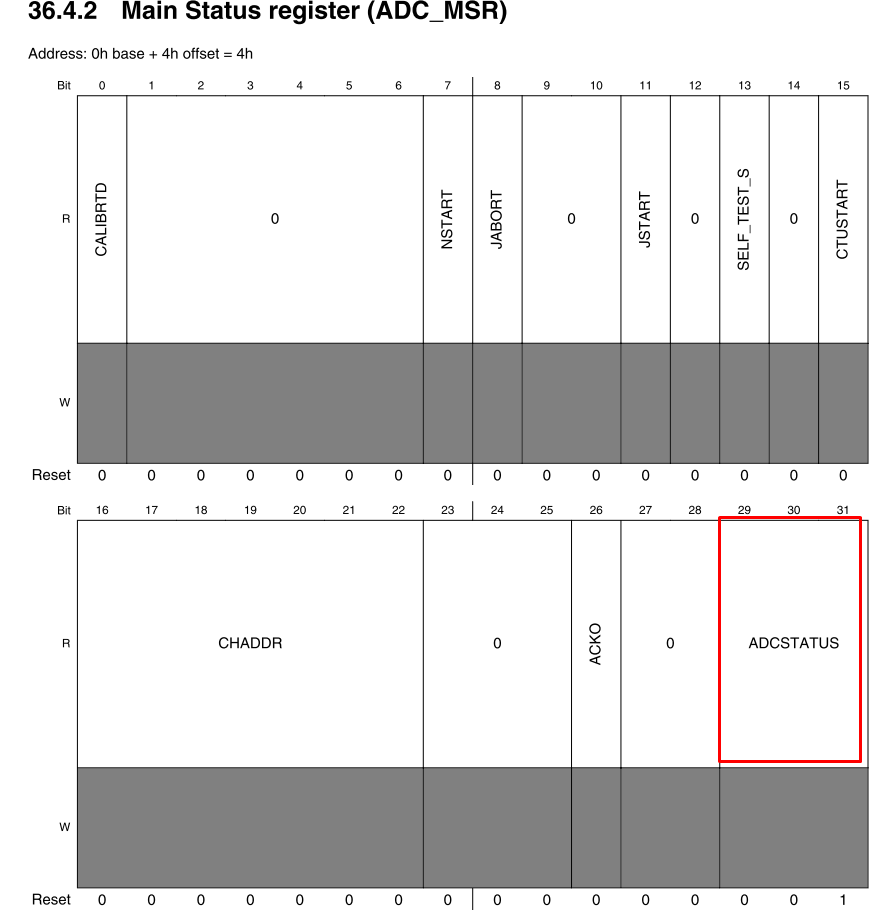

When this issue happens the ADC module is working normal and ADC Status is toggling between state  4 and 6 but the CDATA reg is frozen to a fix value
CDR Registers
so they all lock up to same value of 1171 decimal (0x493 Hex) and the Valid bit remains high
The CPU and BandGap shows the same behavior.
Could you please help me on understanding why the CDR reg is locking up?.
Kind Regards,
Ali Meraj

petervlna
The ADC module restart didn't solve the issue as the ADC values remain frozen even after trying to restart ADC module.
How did you restart ADC module? Did you turn it of in PCTL register and then mode transition to RUNx and back?
It looks like the ADC conversion finished and new one is not started.
(So the ADC is not stuck but staying in defined state and waiting for new conversion trigger, either SW or CTU)
This I do not know as I have only limited information on how do you use ADC.
regards,
Peter

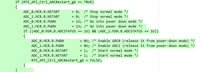

I took the ADC to power down by setting power down bit to 1 then wait till the ADC status is changed to power down then restart it. i have attached the code of ADC restart.
I am using SCAN mode for normal conversion not CTU mode.
so at the startup of the code the ADC is started once by setting NSTART bit to 1 and then just read the data from CDATA
i have attached the code of ADC config and ADC read every 1ms
I hope this explain how the ADC is setup.

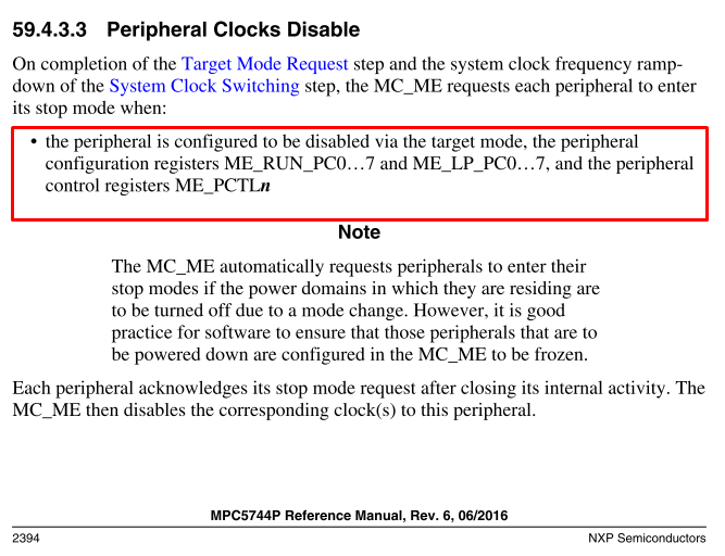

you mention about PCTL register could you please provide more information on restarting the ADC using PCTL reg.
Please let me know if you need more information.
Ali Meraj
7,076件の閲覧回数
petervlna
PCTLx will cut off the clocks to ADC.
Refer to reference manual:
59.3.52   ADC_0 Peripheral Control Register (MC_ME_PCTL237)
But I have just tested it and it will  not erase the ADC registers. (they are on PBRIDGE) so after restoring the clocks to ADC the registers value it the same.
I guess only way to reset the ADC registers is to trigger reset of micro.
