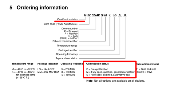

WHat's the difference between MPC5744 and SPC5744?Thank you.
1,183件の閲覧回数
petervlna
Please see datasheet:
Peter

OK.Thank you very much!
