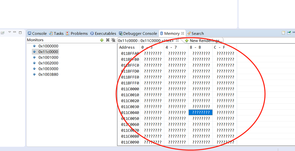

Hi NXP Expert,
请教一下如果想用JTAG读flash中的内容,有推荐的PC软件吗?客户用S32DS for Power读,读到的都是?,请问一下这是什么原因呢?
感谢
Sophie

lukaszadrapa
No, you would not be able to establish the JTAG connection ever. This looks rather like ECC errors. Most likely, it was caused by unexpected termination of erase operation. To recover, you can try to erase the flash.

sophie-wang
Hi Lukas,

lukaszadrapa
