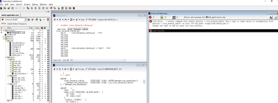

I met this error with codewarrior  while making mpc5604 app
Link Error   : Linker command file output section '.ivor_branch_table' has a type or input which is incompatible with
section '.ivor_branch_table' in file 'F:\VCU_QLD4 -a\app\code\edv24_bsw.o'.
Change the type or add an input for this section.

Seems there is an issue with .section statement of .ivor_branch_table section in edv24_bsw.a which is not declared as VLE code but rather as default code (PROGBITS).
I'd suggest you to use syntax below.  It causes to uses the same elf type/flags from section text_vle (vle code) to .ivor_branch_table section since it contains VLE instructions.
.section .ivor_branch_table, text_vle
Hope it helps.
