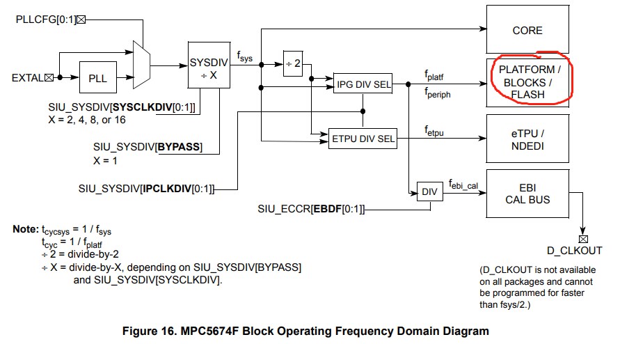

Hello,NXP:
  Does SRAM belong to PLATFORM/BLOCKS  in MPC5674F ?
  if so , SRAM bus clock is F_platf , and the number of wait state used for read and write operations (MPC5674F RM,  Table 10-3) is also related to F_platf .  Is it right?
1,710 Views
davidtosenovjan
Yes, you are right.
