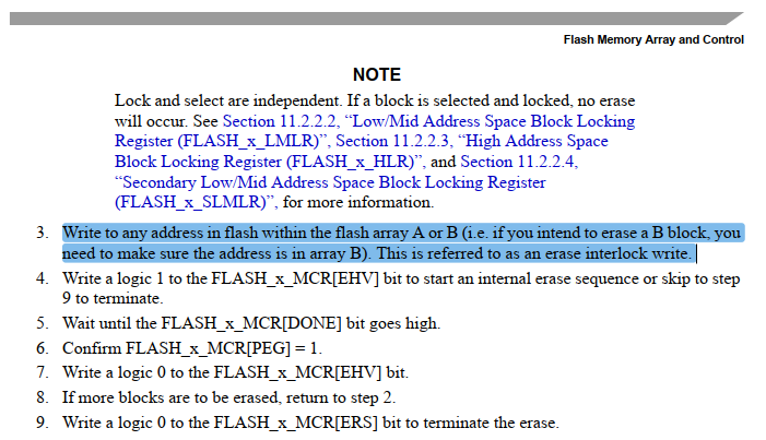

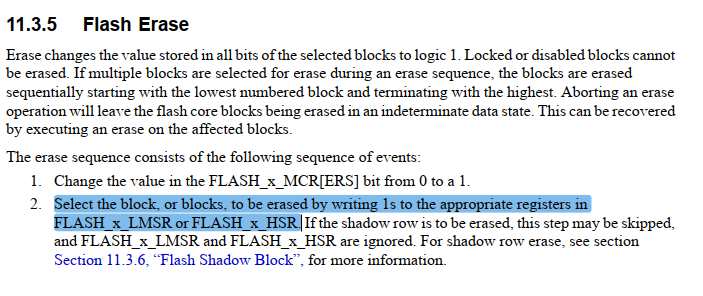

4,192 Views
davidtosenovjan
1) It can be any value, important is an address of the access
2) In case erase interlock, it only needs to point to flash array A or B, blocks to be erased are selected by registers as marked on the screenshot below.
4,192 Views
