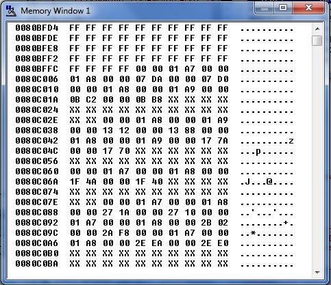

Now I am trying to save some data (acquired from sensors) in DFLASH using the following program. (the  main calls the program void writesamplestoflash (void) at regular intervals)
I am successful at saving same data to the memory but I am facing a small problem.
When I see the memory (dflash) through memory window in debugger, some locations appear as XX and also I am not able to read the data at these locations.
I have also attached an image of memory window from debugger.
Can you tell me the reason for this. Also tell me if I can save data in some better way.

lukaszadrapa
"XX" in PEmicro debugger means that there are bus errors - in this case ECC errors.
Copied from reference manual:
"ECC is handled on a 64-bit boundary. Thus, if only one word in any given 64-bit ECC segment is
programmed, the adjoining word (in that segment) should not be programmed since ECC calculation has
already completed for that 64-bit segment. Attempts to program the adjoining word will probably result in
an operation failure. It is recommended that all programming operations be of 64 bits. The programming
operation should completely fill selected ECC segments within the Double Word.
Programming changes the value stored in an array bit from logic 1 to logic 0 only. Programming cannot
change a stored logic 0 to a logic 1."
So, if you want to change any double word that is already programmed, it is necessary to erase whole block.
Lukas
