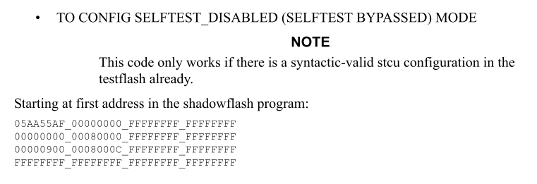

We are testing the BIST feature available in MPC5643L. With default configuration in shadow memory, it executes the BIST(LBIST & MBIST) and the corresponding status are available in the relevant registers.
Now, we would like to bypass the self test by writing the below code in the shadow memory by using algorithm "Freescale_MPC5643L_1x32x4k_Shadow_Blk.pcp" & application "cw_progppcnexus.exe"
188951_188951.pngpastedImage_4.png##@
But even with above configuration code, the self test is being executed and status available as "Self-test complete" .
Can anyone help us with configuration procedure or additional settings required if any?

You have to write to mirror of shadow flash.
Use the following (from Lauterbach debugger script) - data are correct but your start address must be 0x00FFC010.
Then it will work as expected.
Example:
;To config SelfTest_Disable (SelfTest Bypassed) mode
d.s EA:0x00FFC010 %BE %LONG 0x05AA55AF
d.s EA:0x00FFC014 %BE %LONG 0x00000000
d.s EA:0x00FFC018 %BE %LONG 0xFFFFFFFF
d.s EA:0x00FFC01C %BE %LONG 0xFFFFFFFF
d.s EA:0x00FFC020 %BE %LONG 0x00000000
d.s EA:0x00FFC024 %BE %LONG 0x00080000
d.s EA:0x00FFC028 %BE %LONG 0xFFFFFFFF
d.s EA:0x00FFC02C %BE %LONG 0xFFFFFFFF
d.s EA:0x00FFC030 %BE %LONG 0x00000900

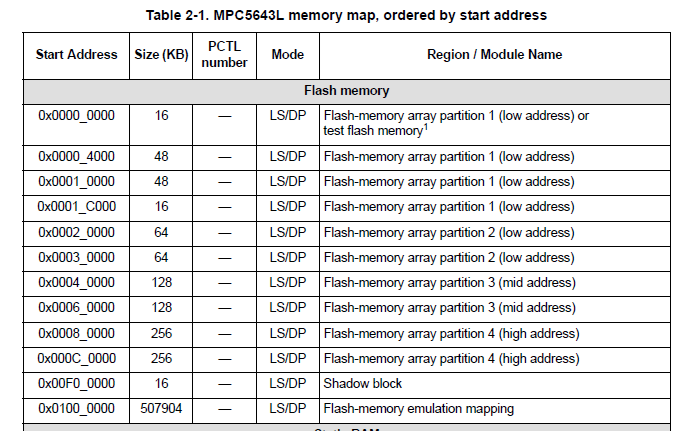

There is no such memory region specified in the datasheet as mirror shadow flash.Is that address range valid?
The algorithm to access the shadow flash region doesn't cover the memory range mentioned by you.

Yes, I agree with you it is not described in reference manual.
But if you want to configure self test you have to write to this mirror as I have posted above.

The shadow flash content must be as described in reference manual:
I have always used Lauterbach debugger for programing BIST bypass and never had any issues.
I can provide you my script if needed.
Could you share shadow flash dump after programming BIST bypass?
Peter
