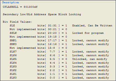

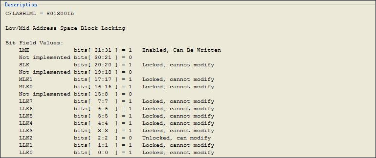

and the debug register I can see the block is unlock correct :
after executed the erase operation ,the returnCode is C90FL_OK ,but in the flash block 2 ,the value didn't be erased.

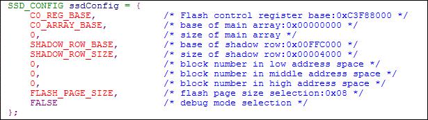

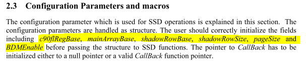

do not write to ssdConfig like this:
During initialization phase, you are supposed to initialize the ssdConfig in this way (copied from demo code):
/* CFlash */
SSD_CONFIG ssdConfig = {
    C_REG_BASE,             /* Flash control register base */
    C_ARRAY_BASE,           /* base of main array */
    0,                      /* size of main array */
    SHADOW_ROW_BASE,        /* base of shadow row */
    SHADOW_ROW_SIZE,        /* size of shadow row */
    0,                      /* block number in low address space */
    0,                      /* block number in middle address space */
    0,                      /* block number in high address space */
    C90FL_PAGE_SIZE_08,     /* flash page size selection */
    FALSE                   /* debug mode selection */
That's mentioned in user manual:
Then call FlashInit(). This function will read the flash configuration information from flash registers and it will initialize the rest of the parameters: mainArraySize, lowBlockNum, midBlockNum and highBlockNum.
You are not supposed to modify the ssdConfig anymore.
Then it should work.

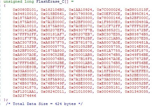

otherwise ,I use  the following c_array:
I don't know what's the root cause ,and what about you ?

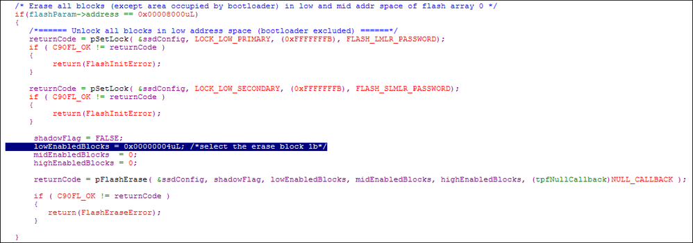

2. Remove the ssdConfig information ,and set the  lowEnabledBlocks = 0x00000004uL;because I want to erase the block 1b(base address is 0x00008000) .
There is a problem :when set the  lowEnabledBlocks = 0x00000004uL, the erase function pFlashErase will run away .
but I set the lowEnabledBlocks = 0x00000002uL, the erase function pFlashErase will return C90FL_OK, but still can't erase success  .
From the above ,I am confused what value  should set about the lowEnabledBlocks  parameter ?

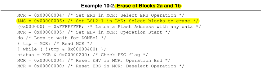

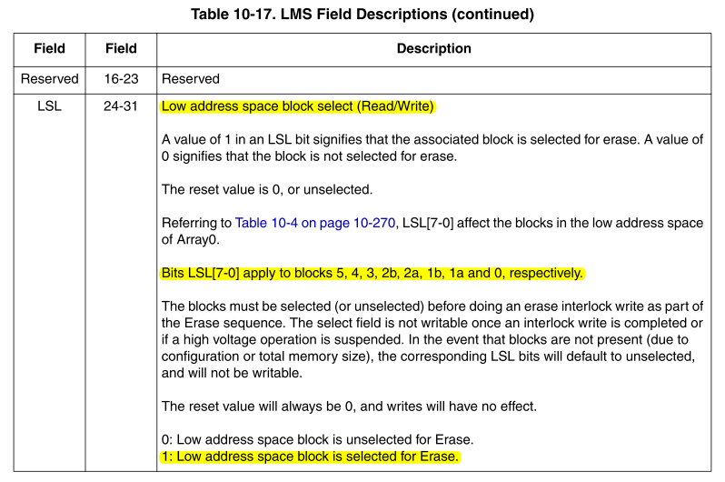

I check the MPC5634M manual ,there is a example :
the example erase blocks 2a and 1b ,the LMS=0x00000006;
but form the LMS register description if erase the blocks 2a and 1b,the LMS Should be equal to  0x0000000C.
is it right about my understanding ?

To erase block 0, you need to set lowEnabledBlocks = 1;
To erase block 1a, you need to set lowEnabledBlocks = 2;
To erase block 1b, you need to set lowEnabledBlocks = 4;
To erase all these blocks, you need to set lowEnabledBlocks = 7;
That's a good point - there seems to be a typo in Example 10-2. I agree, there should be 0xC.

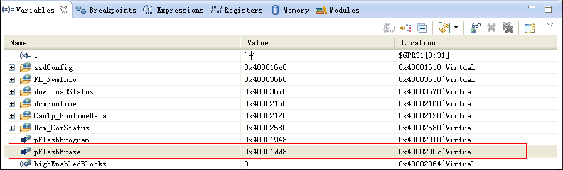

Today I Transplant the example code to my project ,and I close the other function .it means the project just the transplanted code .in the code I erase block 3(0x0001c000-0x00020000). The result seems same as my code .That means when erase the block ,the program will runway.And I check the memory the value is 0x00000000,seems not correct.you can see it in the following :
the code  as the follow:
we can know the pFlashErase runing in the RAM ,right?

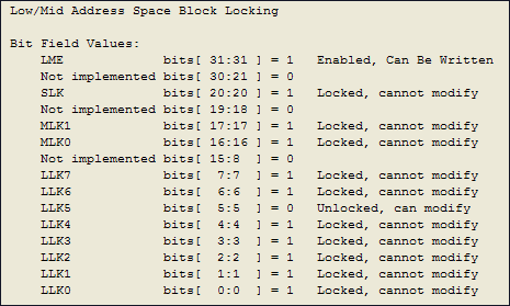

and the register:
LCF configuration:
In my thinking ,all the above information is ok ,but I don't know why the result is not correct ?

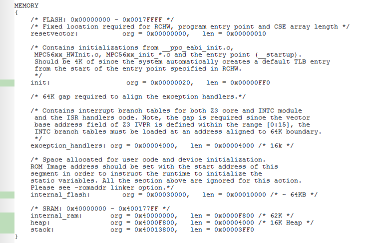

 Thanks for your quick response,and I am sorry I forgot to tell you what  's my design idea.
1.The LCF configuration as follow :
This is the bootloader field :
2. As you said ,I  have defined three instances of ssdConfig which like the example ..
3.And the code running from the RAM .I  re-define the  C-array drivers as variables (just delete “const”) and they will be automatically copied to RAM by startup code.
Here just the  C-array drivers locate the Ram area , whether need to define the function which called the  C-array drivers in the Ram area? For example ,in my project the function ;EraseFlash().
I will have a try with your example project if still erase failed .
