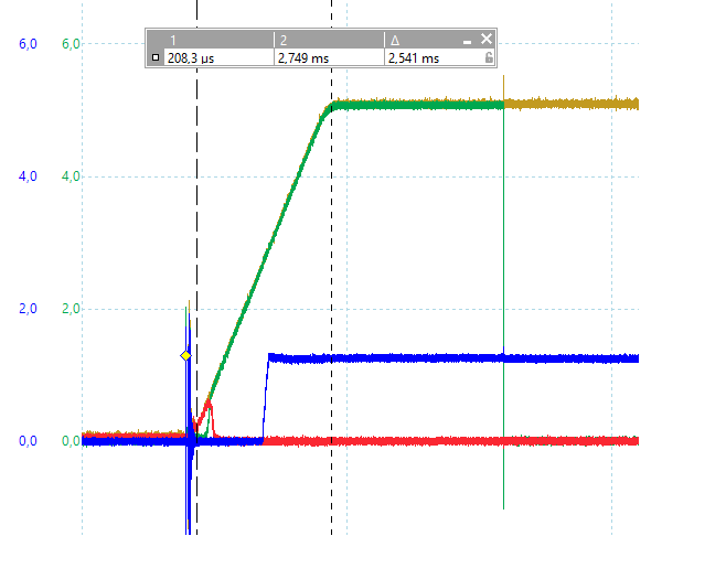

Bananajoe
I am using MPC5743R MCU together with a new development card we developed. I have measured core and vdd power ok (vdd = 5V, core = 1.236V). The reset pin is pulled up to 5V via 4.7k resistor. But for some reason the reset is always low, and I mean always. I have never seen it high. I cannot figure out the reason for this.
Do you have any idea how to proceed or what the problem might be?

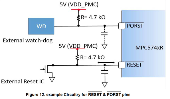

The problem was that PORST and RESET was connected. This was due to that 2 zero ohm resistors was installed when only one should have been installed.

Just to add (for potential other readers of this thread) how RESET and PORST signal are supposed to be connected.
RESET and PORST cannot be connected to one input as RESET is bi-directional signal and it would keep device in POR state.

Here is the startup sequence.
Yellow: VDD
Green: RSTOUT
Red: Reset
Blue: LV
PORST looks exactly like Reset.
Mathias

I cannot see the reset escalation stuff that I have been reading a lot about of late. The reset is simply never rising after the small bump in the very beginning.
By the way, here is the sequence with another board we have (but with MPC5746R insetad of MPC5743R) that actually works:
Here the reset rises as expected after 10ms.
