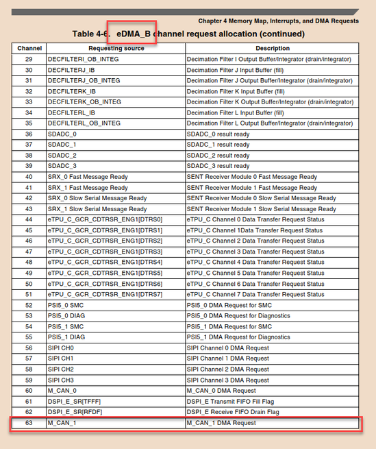

i have tried to receive data using MCAN1 with eDMA but it's not working .I've included my code below please suggest necessary changes

You cannot use DMA chnl 0, but the channel assigned to MCAN.

I have selected **MCAN1** only, but as you can see in my configuration , in the EDMA component we can configure MCAN1 and it only allows selecting the channel number. I have not used channel 0. i have added image and you can see in my code also
