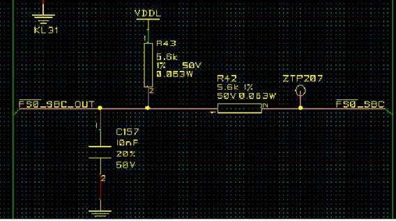

I'm asking a question about the MC33908 SBC in companion to a MPC5744P. We've noticed some strange behaviour on the FS0 output during a requested reset of the processor.
The attached trace shows !RST in yellow and !FS0 in green. The falling edge of !RST is caused by a request from the microprocessor over SPI to the SBC to have its reset line asserted. This will cause the fail-safe state machine go back to its init state, and cause FS0 to become asserted.
As you can see, !RST is released after 16ms - but look at the voltage level of FS0 - it certainly isn't a convincing digital
state.
After !RST is de-asserted, software starts again going through the complete initialisation of the SBC again, including the fail-safe state machine, watchdog, and zeroing of the reset error counter.
After all that is done, software attempts to have FS0 de-asserted. I assume this happens more or less at the time where there is a step in the green trace - 10ms after software start would be about right.
As you can see, FS0 is not at a valid voltage level thereafter - not surprisingly, connected fail-safe outputs are inhibited.
The circuit on the FS0 pin is pretty much as recommended; a 10nF capacitor to ground, 5k6 pull-up to 3V3, 5k6 in series to the rest of the world - which in this case is all CMOS logic devices (3 off).
Interrogation over SPI of the WD_ANSWER register shows that it thinks FS0 is de-asserted and everything is perfectly fine.
Has anyone else seen the FS0 do that?

Looks like the issue is with external circuitry. 'FS0'_SBC_OUT works OK when I remove R42...I took a look at a logic gate attached to 'FS0'_SBC which did not look like it had reflowed properly. After re-wetting the pins, the logic level on that net now looks good. I think that gate was missing its supply or ground connections.
Thanks for your thoughts in looking at the issue.

Thanks for your response. Attachment shows where/how processor lines are attached to SBC. The net called VDDL is the VCORE output from the SBC and is 3.3V. This is also the net connected to the VDDIO pin of the SBC. VCCA = 5V (with internal transistor). VAUX is set up as a tracking regulator with an external PNP. All of that is working fine.
For completeness, I have also patched in how the !FS0 line is used downstream of the series 5.6k; you can see it connects to CMOS AND gates as a combinatorial function with a microprocessor output pin.
I note compared with Figure 58 of the latest MC33908 datasheet that my schematic uses 10nF tank capacitors on !NMI and !RESET (pins 29 and 24), the datasheet suggests 1nF. This may account for the slower release of reset than you were expecting, but I would hope that shouldn't affect the behaviour of the fail-safe state machine.
I'll get you a trace as requested; any thoughts my use of 10nF might cause a problem?

From your schematic extract I understand that FS0B_SBC_OUT is the SBC device pin. Can you please desolder R42 in order to isolate FS0B and verify if the behavior becomes OK nor not?
- If yes, then it is an external issue.
- If no, then there is a link with the SBC, but so far I cannot explain it.
It looks like when FS0B is asserted low, there is a voltage divider not allowing FS0B low level, but forcing intermediate value…

I've been away for the last few days.....but will get back on this shortly....to keep the project running before I left, I de-soldered R42 myself and tied the line high...I will get the board and take a look at the SBC side of the joint to see if it is still floating.
