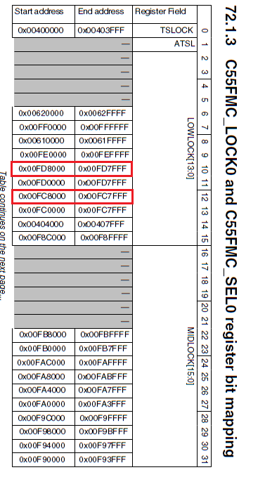

I believe there are a couple mistakes in the  LOWLOCK Address Range of the MPC5746C Reference Manual.
I believe the first one should read
   0x00FD 8000     0x00FD FFFF
The second one should read
   0x00FC 8000     0x00FC FFFF
MPC5746C Reference Manual, Rev. 5, 10/2017
Tags (2)
803 Views
petervlna
Yes you are right.
I will notify the documentation team.
