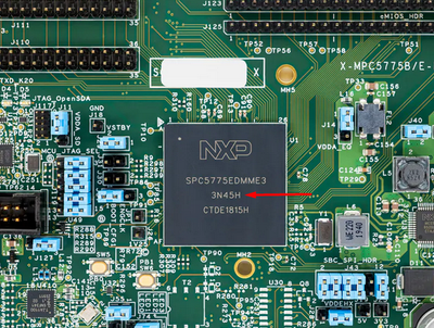

Well, programming the STCU based on your own configuration.. I would not recommend doing that unless you have deep knowledge on STCU mechanism and lot of testing possibility.
Could you verify if my instructions are correct or not?
I have attached reference script. Furthermore checksums depends on device cut, which you do not share with me. So make sure you have the same as I. -> 3N45H
If I embed the corrected srec to the mcu, is it going to work?
Cant say. But if it is correct STCU configuration validated by NXP, it will.
Can I show if STCU2 module is working correctly via a manual or a paper?
Sorry, I do not understand this questions. STCU is HW module operating dependent on voltages, memory conditions, peripheries, etc...
Because as far as I understand, there is no way to corrupt the device without actually harming it.
By programming STCU DCF records, you cant harm device. But messing with UTEST flash, you definitely can corrupt device.

Hey @petervlna and @Furkan_26,
I also had a similar problem about the excel.
So make sure you have same device cut.
How to check this? What is a device cut?
You can read MIDR register.
Or simply have a look at device package:
Peter
