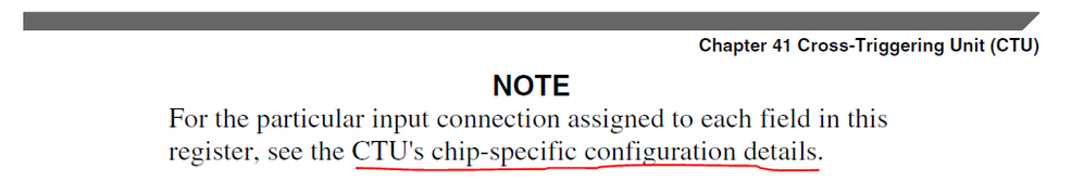

I am reading through CTU section and I see the following note on page 1215 of MPC5744P Reference Manual, Rev. 6, 06/2016.
Where can I find all the inputs to CTU? I don't find them in reference manual nor in datasheet.

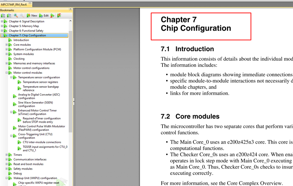

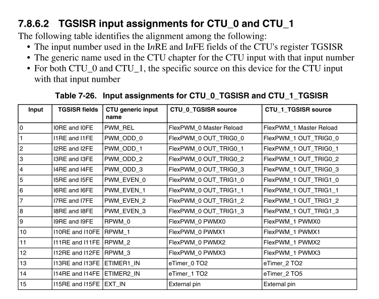

petervlna
This is quite simple. It is chapter  7 in reference manual.
and the inputs:
