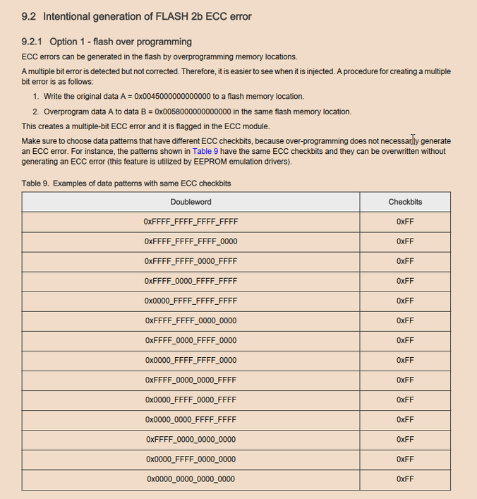

However in flash you may create ECC error also by over-programming as I described in AN13179:

I am referring the code you had shared in some other query for generating ECC error.
MPC5777C-1b+2b_FLASH_ECC_error_injection-v0_0-GHS614
I tried with the functions stand alone in my code: Generate_noncorrectable_FLASH_ECC_error and Generate_1bit_FLASH_ECC_error
What I observed is that memory area is not getting written second time I execute these functions. Controller performs a reset if we read the memory address in flash (0x00FC0000).
Since I need to perform this test at every PowerOnTest, I need this function to run quite frequently.
I was not able to check whether ECC error is injected or not - I will let you know on that.
I want to check can I refer that piece of code in my usecase ?
189 Views
davidtosenovjan
It is probably reset by FCCU. Do you have set FCCU reset reaction for MEMU input? Have you investigated reset reason (RGM module)?
