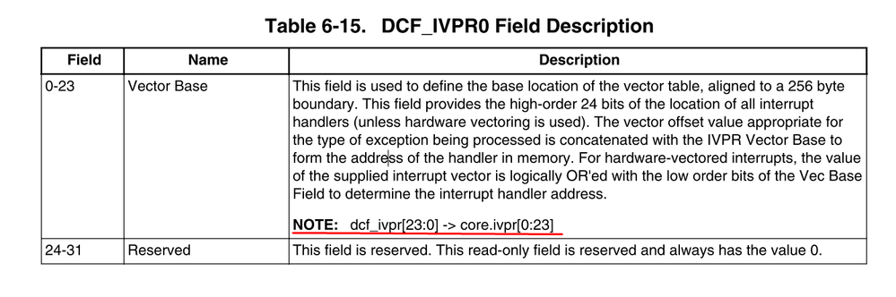

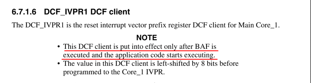

Hi im programmed the DCF Records and i have this.
Factory:
StartRecord[0x400300]: 0x5aa55af00000000
OPT_EN0[0x400308]: 0x1000000200020
I added:
IVPR1_1[0x400310]: 0xfd1000010000e4
IVPR1_2[0x400318]: 0x2efff010000e8
IVPR1_3[0x400320]: 0x7e8800010000f0
If i set in assembly asm("mfspr %r4, 63 "); i get the ivpr1 address and it results in 0x00 but according with the DCF Record i should get 0xFD1000. For other hand, in the address 0x4000C0 in the excel of reference manual say "Soft DCF Record Start Address" but i think is if i want to set an address diffrent from 0x400300. My principal question is it initially DCF Records are working or i have to set the address value 0x400300 in the position 0x4000C0 to make that, so initially the BAF section is possible to erase and program freely.

Yes the BAF is OTP if you cant erase it.
Pay attention to:
and
I have tested it and I can see IVPR1 being updated by BAF execution once I add DCF records.
