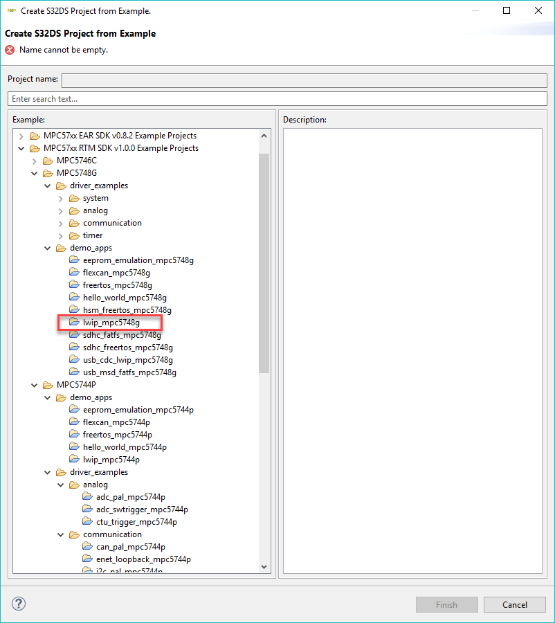

I am working with MPC5748g LCEVB. I want to receive some data from a system via Ethernet. To send data I need to set the IP address. I want to know whether the MPC5748G LCEVB support layer3 (Network layer).

microcontroller supports layer 2 of OSI model by hardware. Upper layers must be implemented in software, for example using TCI/IP stack.
In S32 Design Studio, there is an example of lwIP stack, which you can use.
Please install S32 Design Studio and the newest update, and then create lwIP project from example.
