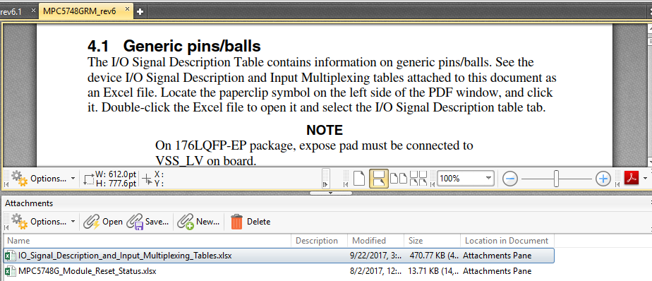

Could any one share me "IO_Signal_Description_and_Input_multiplexing_tables.xls" file for MPC5748G 176QFP package. This file is not attached on  MPC5748GRM under section 4.1.1.

you must see attachments in the pdf file.
it could be some pdf viewer does not allow to show this.

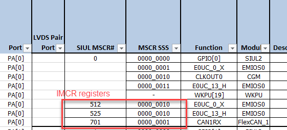

I can find the excel attachment "IO_Signal_Description_and_Input_multiplexing_tables.xls" , but it seems that the table "Pin Muxing" like that in the reference manual of MPC5744P still misses., which is needed for pads configuration. How do you fix that?

no fixing is needed, this excel contains all you need to properly configure the pad, it has same info as MPC5744P Pin muxing table.
the usage of given register number depends on SIUL structure definition in device peripheral header file.
There could be MSCR[1024] defined but most often MSCR[512] followed by IMCR[512]. In this case you need subtract 512 from given number, e.g.
SIUL.IMCR[525-512] = 2;  // connect eMIOS0_ch13 input with pad PA[0]
