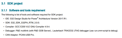

I'm trying to develop it using RDVCU5775EVM based on mpc5775B.
going to use this board to do torque vectoring.
I am referring to the following guide :
https://www.nxp.com/webapp/sps/download/preDownload.jsp?render=true
If you look at the user guide provided by nxp, there are two debugger items.
-> P&E multilink , TRACE32 JTAG debugger
P&E multilink is available, but TRACE32 JTAG Debugger is not available.
So I posted a question because I was wondering if TRACE32 JTAG Debugger is a must.
If you don't need a TRACE32 debugger, I'd like to know the solution as well.
Could we get help?

you need only one of those JTAG tools.
Pemicro Multilink probe and S32DS debugger are rather entry-level tools, Trace32 is advanced debugger which is much more expensive.
Pemicro Multilink probe can be bought from NXP:
https://www.nxp.com/design/software/development-software/s32-design-studio-ide/universal-multilink-f...
or directly from Pemicro:
https://www.pemicro.com/products/product_viewDetails.cfm?product_id=15320180&productTab=1
For Trace32 and tools you can ask for quote at www.lauterbach.com
