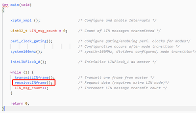

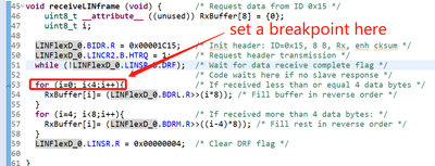

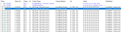

  I new a project from example called "linflexd_lin" , and download it to the devkit, using oscilloscope one can observe transmitted waveforms.
 Next step, Adding "receiveLINframe();"function to the main loop, while connecting the P3.4 of devkit to the Lin pin of the CANOE.
  And then, sending periodic messages to simulated slave node using CANOE, as shown below:
I set a breakpoit in the function "reveiveLINframe" 。
But it doesn't stop running at this breakpoint, it seems that the MCU did not receive the message from slave node. Where is the problem?

PetrS
for receiving data be sure CANoe is set to respond on given ID and check the RX frame on bus with the scope too.
You can refer to master/slave example on https://community.nxp.com/t5/MPC5xxx-Knowledge-Base/Example-MPC5748G-LINFlex-LIN-Master-Slave-test-G...
BR, Petr

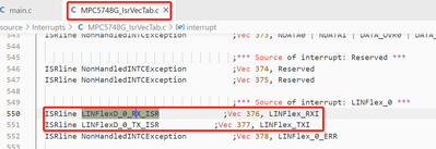

   Thanks for your advice. I transplanted the master/slave example to my project. But there are still some problems:
1)The Rx/Tx ISR of LINFlexD_0 as slave node is registered in the interrupt vector table.
But where and how to register the Rx/Tx ISR in my project using S32_SDK_S32PA_RTM_3.0.3?
I try to use the API "LINFLEXD_UART_DRV_InstallRxCallback()" and "LINFLEXD_UART_DRV_InstallTxCallback()", but failed. The result is that while the master sends data, the slave does not receive it.

There are the API to register the ISR:
INT_SYS_InstallHandler() and INT_SYS_EnableIRQ()
