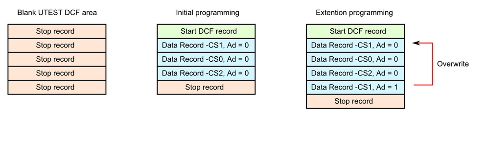

Thanks Peter, I am able to update only once at specified address, please guide me how to modify existing DCF record
2,250 Views
petervlna
I strongly recommend you to read DCF record chapter in reference manual before any DCF operations.
DCF is located in UTEST memory which is OTP.
here is the DCF record update procedure:
You have to add new record with updated values.
Peter
