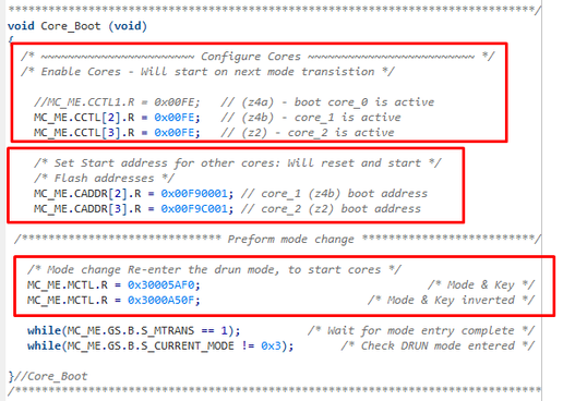

I am using the sample project [MPC574XG-MCAL4_0-RTM_1_0_5_Sample_Application] with the compiler GHS and the command [./launch. bat OS TOOLCHAIN=ghs]
】Compilation passed. Multi cores are configured in the EB project, and the generated code is also replaced in the subdirectory [cfg] of [MPC574XG_MCAL4_0_RTM_1_0_5_Sample_Application]. In addition, the function StartCore (OS_SECOND_CORE,&setValue) is called in the main function to start the slave core. It can also be compiled and passed. However, after burning the generated elf file into [DEVKIT-MPC5748G] and stepping into the function StartCore, it was found that the slave core did not start. May I ask how to solve this problem? Thank you.

To start the core you need 3 simple steps.
1. set start address
2. enable core in desired RUN mode
3. do mode transition.
I expect you are not calling mode transition after you enable cores as if I remember correctly mode translation is separate function.
This is all you need, make sure your MCAL SW is doing that:
Peter

Hi,Peter
Following the three steps provided, I attempted to modify the software, but still couldn't successfully start multi-core. Can you provide a multi-core project based on MCAL+OS.

Hmm, did you verify if the registers are updated in your project according to the sample code I have shared?
Furthermore I will ask if there is an MCAL+OS multicore example available.

Hi,Peter
I have debugged it again, and the multi-core can now start. thank you very much.
