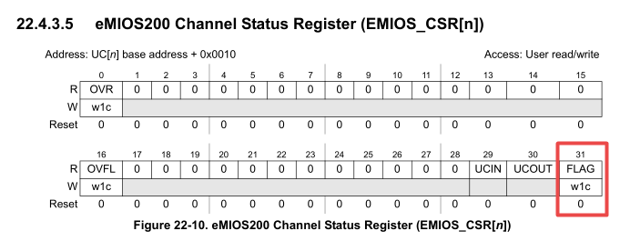

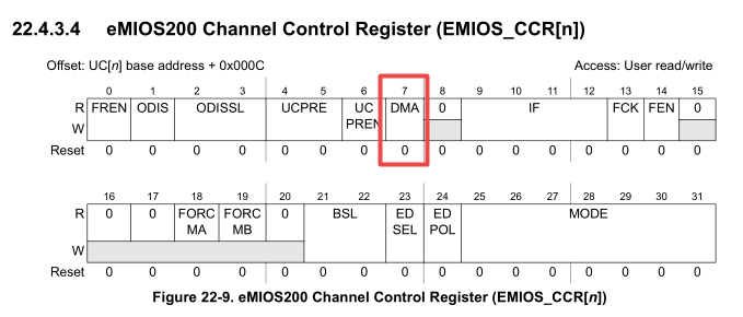

i don't know how to use EMIOS_CCR[n]_DMA and EMIOS_CSR[n]_FLAG bit ?

I did not see a demo using DMA for updating CADR/CBDR in PWM output modes. Maybe some code for input capture mode using DMA can be found.
Anyway, if DMA bit is set, the FLAG generates DMA request. You can program the DMA channel to do what you need finally. If DMA bit is set the FLAG is cleared by DMA controller after DMA transfer is done.

In OPWFMB mode, when will the FLAG bit be set ? match CADR ? match CBDR ? or both ?
tks!!!
3,372 次查看
PetrS
this is determined by MODE[5] bit. FLAGs can be generated only on B1 matches when MODE[5] is cleared (MODE=0x58), or on both A1 and B1 matches when MODE[5] is set (MODE=0x5A).
