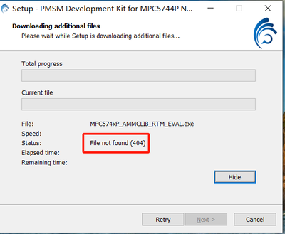

I want to get the source code for "MPC5744P 3-phase PMSM Development Kit", but the exe installation package I downloaded as instructed cannot be installed.As follows:
So I want to know how I can get the source code, looking forward to getting the expert's reply, thank you!

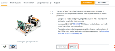

Also, I downloaded it here:MPC5744P 3-phase PMSM Development Kit | NXP Semiconductors

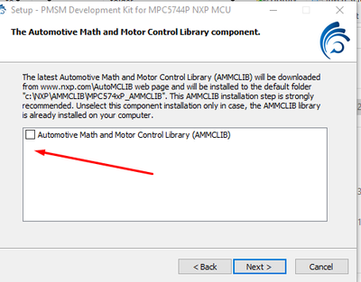

There is an issue in installation package with AMMCLIB.
Please uncheck it and install it later separately.
Peter

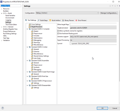

Peter,Thank you very much for your patient reply.However, after I installed the software according to your guidance, I also added the compilation path of the.h file after getting the source code, but unfortunately it still doesn't look normal. Do you have a complete project that can compile normally? If so, please send it to me, thank you!
2,297 次查看
petervlna
To be honest, I have spend few ours yesterday to get it running.
Issue is that library paths are different.
You need to change EWL version to S32DS v2.1
I am also attaching modified project
